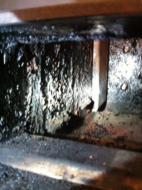

  • HEJ
    thanx for these pics. firsttime i got wondering about the state of my s4 - i see on your pics flake offs on the stone, also ist is ripped - think it is ok.
    so - i have testet a lot of thinks - finally i changed back to defaults. i took the setting for little damp (<8%).
    next i changed the settings for buffercharge pump - i think it is much to small if the pump is not loading faster as ~30/40% - i took 65% minimum on bufferpump - so the S4 is required to fire up - an not go down to little flame, slow down exhaust ventilator etc etc etc.
    SO i get a good temperature of ~80° - STABLE - exhaust temperature round 190° - lambda co of ~7% (got testet with 6% - works really fine).
    MY Problems why i changed settings and testet are - teer, sooting, soot depostits - like this --> http://goo.gl/CDxGi --> http://goo.gl/42fKO
